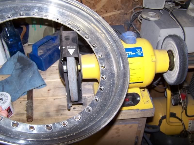

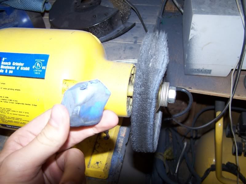

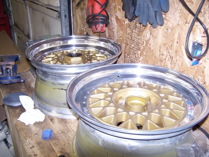

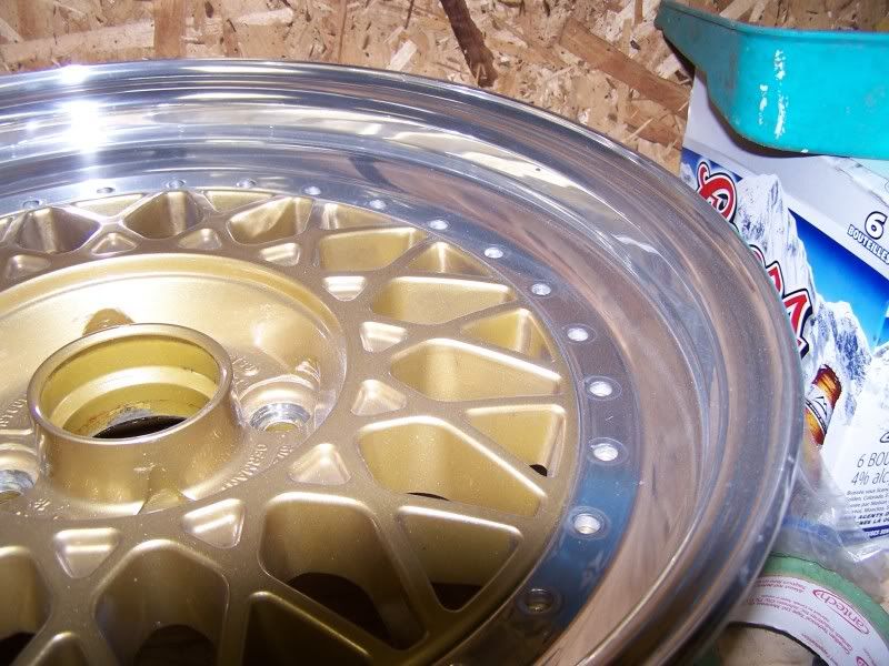

Took apart all my wheels and was left with a few of these.
Took two hours on each lip and ended up with this.
Or, these I guess.. 4 of um..

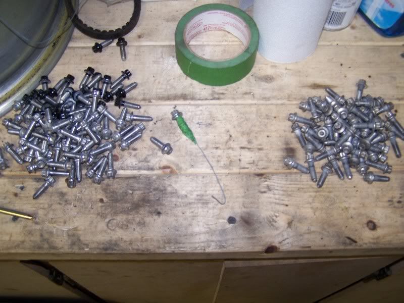

Now, a couple of weeks ago I tried many techniquies to try and get my bolts to be black, without paying 200$ for them. I just, cant justify it. I had a little sucess with gun blueing but, nothing that I liked. SO I handed a wheel lip bolt to Mike over at Extreme Powder Coating and asked him. Can you make dis .. black.. he said.. yis.. I said.. awesome.
A couple of days later, he showed me his work and needless to say I was extremely pleased with the quality, thus I decided this was the best route. Soooo It meant cleaning 150 wheel bolts by hand on a wire wheel to make it easier on Mike. I also have to wrap them in wire and surround the threads with tape, again so mike doesn't hate my life for asking him to do it lol.
150 you say? 30 per wheel you say?

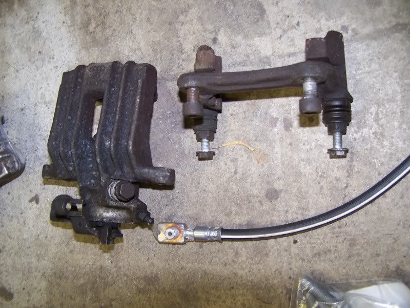

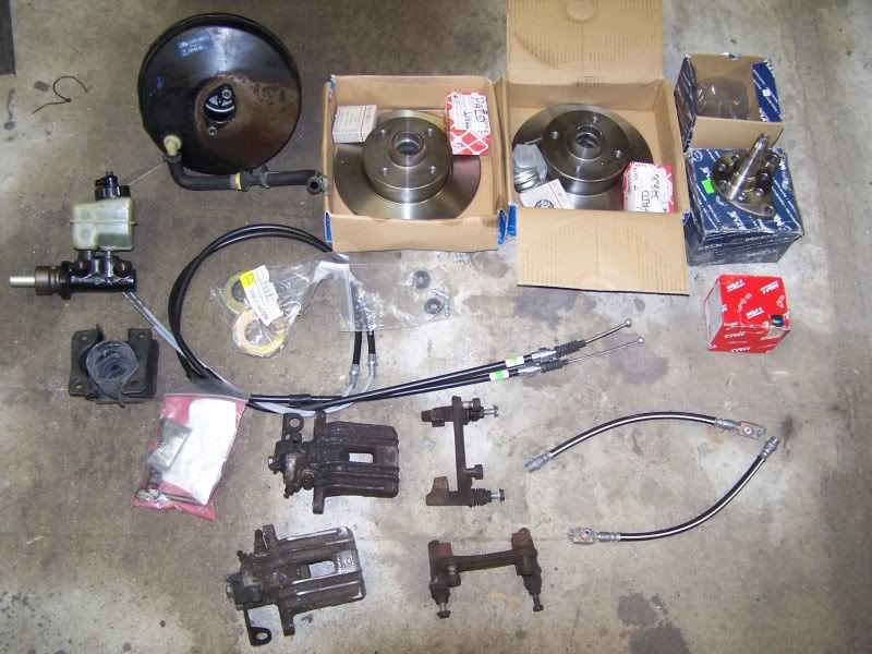

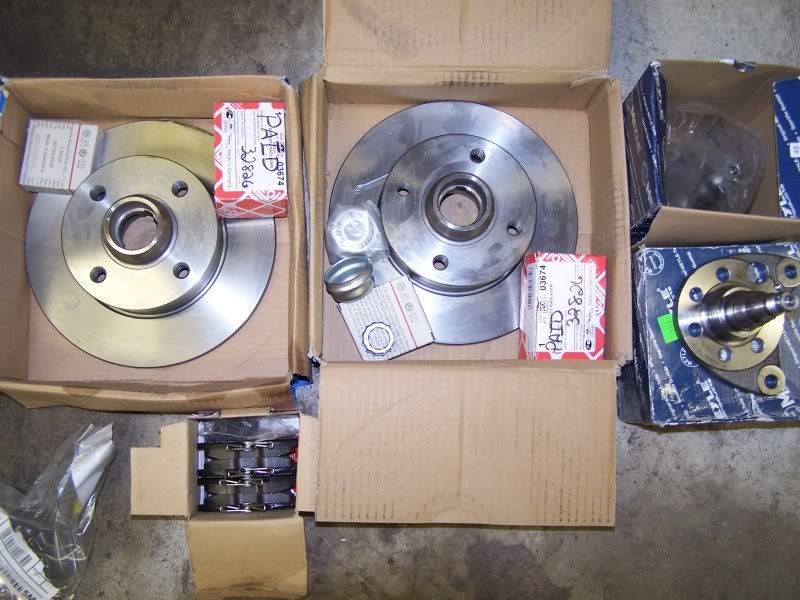

Well, as I had discussed earlier in the posts I had intended on putting rear discs on the car and hopefully upgrading the entire system in general. As you have seen the Wilwood per portioning valves in earlier posts.

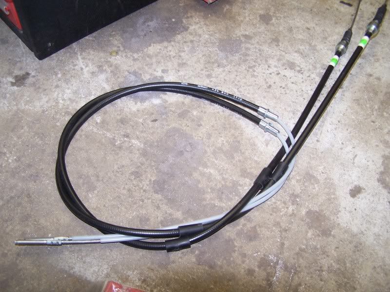

Well , for Cluney and Andy, and anyone else who wants to upgrade there brakes on thier mk1, mk2 or mk3 from much research this is the way to go about it using fairly inexpressive parts.
Scirocco 16V Hand Brake Cables.
MK4 Aluminum Rear Calipers (these are way lighter then the originals) , Audi A6Q 2002-2005 Rear Flex Lines, and MK1 Scirocco Rear Disc carriers.
Then, theres the rear discs, pads, bearing kits, new rear spindles or you can reuse the old off of a rocco 16V orrr mk2 16V

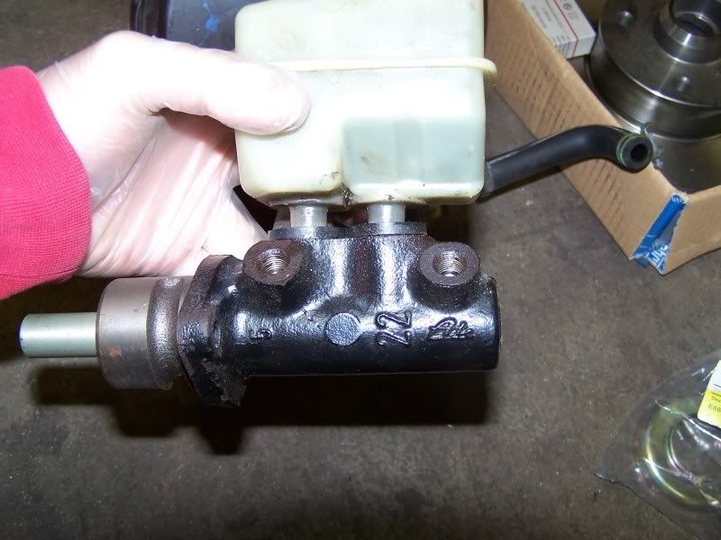

This is the Big one, a 22mm Master Cylinder from a 16V rocco.AND the booster , MOSTLY because the booster will attach to the brake pedal without having to weld on bracket.
All in all, a fair chunk of schtuff.

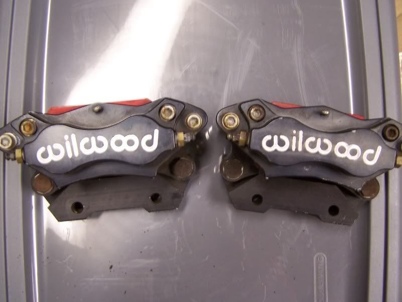

Now, onto my favorite upgrade from this summers parts ordering

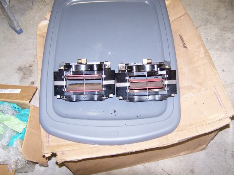

Wilwood 4-pot Billet Dynalite Calipers and EBC RedStuff Pads.
This Calipers are amazing, they weigh 2.5LBS drastically reducing the unstrung weight on the front end of the car. Now, the adapters on top of that make them about 4LBS each.

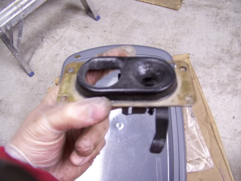

Oh, and a front opening hood latch so I can leave out the release cable.
